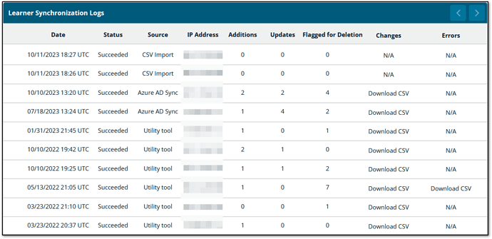

View the Active Directory Synchronizer Change Log
The AD Sync Change Log displays the 10 most recent AD syncs. If any changes were made during a sync, you’ll be able to download a csv file in the Changes column. If there were any errors, a csv download will be available in the Errors column. These files provide details of changes or errors that took place during the sync. To view the Change Log, navigate to Learners > Sync Tools and click the Log of Changes button.
